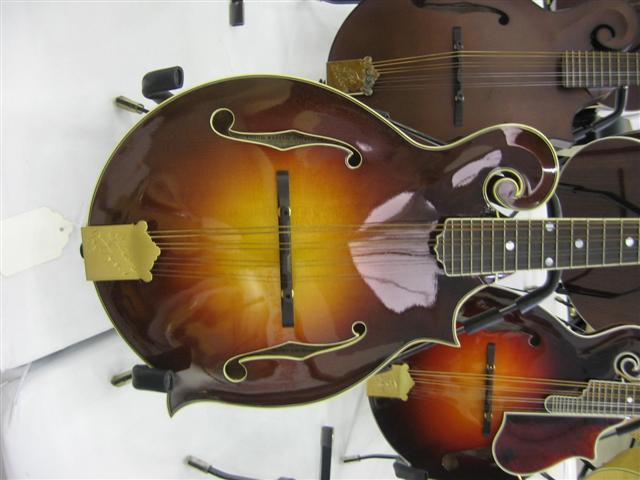

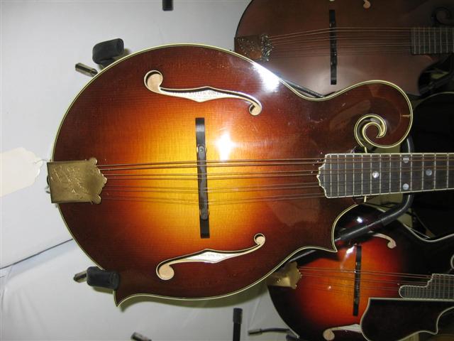

This was a table at the Dallas International Guitar Show. It caught my eye.
PostPosted: Thu Apr 26, 2007 2:16 am
Any F5 lovers, are you kidding; does the pope wear a funny hat?! So who's table was it, I can't make out the name. They sure look nice tho.
PostPosted: Thu Apr 26, 2007 9:12 am
Arnt, I might be wrong, but I believe it says, "The Gibson."
It was near the Gibson booth, but honestly, there didn't seem to be anyone around.
PostPosted: Thu Apr 26, 2007 10:39 am
You could be right, I think I heard about them...
Actually, now that I take a closer look I recognize at least the Sam Bush model and what is probably the Doyle Lawson model so they are Gibsons all right.
Were other mandolin makers present or was this it?
PostPosted: Thu Apr 26, 2007 1:12 pm
Since I was invited by others, and they had agendas, I stopped at a total of two booths of my own choosing.
You sure seem to know your mandos. I took few pictures of guitars for some reason. Next year I go alone....
